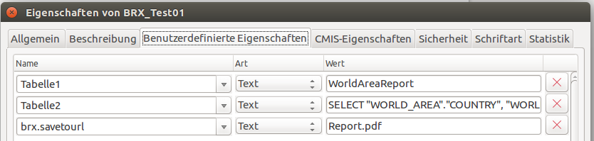

I think there are properties missing. SystemAbort is at the moment just called when the array that should contain the user-defined properties is empty.
to test the export, just add this property
to the file BRX_Test01.ott
g

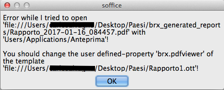

I also tried the "brx.pdfviewer" property but it does not work in Mac OSX with the default program "Anteprima" (with or without path).
Schermata 01-2457770 alle 08.45.15.png (44.07 KiB) 8455 mal betrachtet

I think "Users/Applications/Anteprima" is not a valid commad on Mac. Try
which anteprima
or
which Anteprima
to get the right path - at least on Linux this will work - Macs should be similar
If you got the command, try it inside the extension. The viewer is called by the BASIC-"shell"-command. If it doesn't work you can test different commands like this:
shell("/command/that/launches/Anteprima",,"/path/to/your/pdf",false)
ps: maybe Macs are cASe sESNitIVe?

Found trying and trying, the right command for OSX is:
open -a Preview
Where "Preview" is the name of the app for Italian application "Anteprima".
