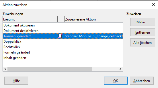

ich habe das mal programmiert, siehe auch Beispiel anbei.
global noldrow as integer
global osheet as object
global bfirst as boolean
Sub S_change_cellbackcolor_in_actual_row(event)
    if not bfirst then goto 100
    S_remove_cellbackcolor_in_old_row
    100:
    ocell = event
    if ocell.supportsservice("com.sun.star.sheet.SheetCell") then
       ocelladdress = ocell.celladdress
       nsheet = ocelladdress.sheet
       osheet = thiscomponent.sheets(nsheet)
       nRow = ocelladdress.Row
       noldrow = nRow
       orange = osheet.getcellrangebyposition(0,nRow,6,nRow)'A=0 bis G=6
       orange.CellBackColor = 16760320
    endif
    bfirst = true
End Sub
Sub S_remove_cellbackcolor_in_old_row
    orange = osheet.getcellrangebyposition(0,noldRow,6,noldRow)'A=0 bis G=6
    orange.CellBackColor = -1
End Sub
Hänge das Makro S_change_cellbackcolor_in_actual_row an das Tabellenereignis
Auswahl geändert.
