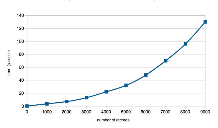

Quite by accident I found and downloaded this extension.gogo hat geschrieben:Feel free to ask in english!
Although it was published as early as March 2016, I don't found a reviews on web sites. Have I not looked well?
I was the first to put "I like", I was the first to try it?
Still it works well. I tested with a Query Base with three fields and 9520 records. The running time is quite long (150 seconds) compared with about 30 seconds of Report Builder. But for smaller databases the time is reduced significantly (see chart).

Thanks for testing and reviewing ...
The running time depends on your
. A "report" is used for small tables e.g. for an invoice or if you order 5 items ...
Therefore the extension focuses on table-layout and not on data-export.
All cell-values are inserted one by one using
so huge data-tables are a time consuming thing, of course.
The extension ensures, that
For exporting data formatted to Calc we have done a similar extension, but it's not ready to publish and furthermore just tested for MySQL ...
- query-layout
- database-layout
- report-file complexity and of course on the
- ammount of data that is insterted
oWriterTable.getCellByPosition(i,ii).setstring(oResultset.getstring(n))The extension ensures, that

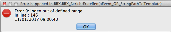

Ciao, I modified the code by inserting the lines in Italian, but I get this error:
What did I do wrong?

LibreOffice 4.3.7
Mac OSX 10.7.5
Mac OSX 10.7.5
Re: BaseReportExtension Support und Discussion [en,de]
the error occurs while calling the sub BRX_SetLanguage and is an index error.
did you change line 100 from
to
... as mentioned here?
dim la_BRX_text(31,1)Code: Alles auswählen
dim la_BRX_text(31,2)... as mentioned here?
because you can not set "la_BRX_text(0,2) = "Report in esecuzione, prego attendere!"" if la_BRX_text(0,1) is the maximum in the second index.change the dimension of la_BRX_text (at top of the module from dim la_BRX_text(31,1) to la_BRX_text(31,2) ), ...
g
